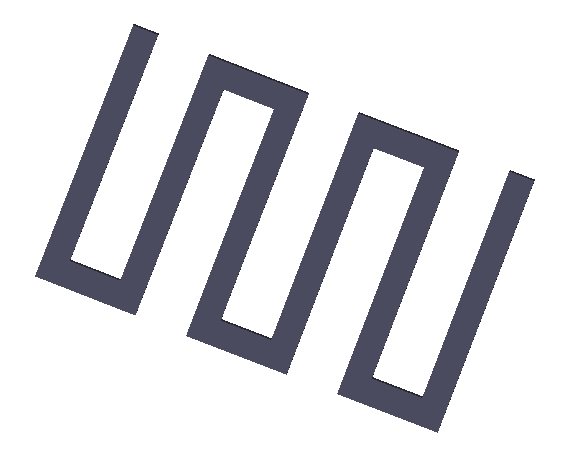

Part 1: Design rules for these springs
Here’s an example of how to design these:
Key:      |
* - .5 mm |
NOTE:     |
The coil  |
is 1 wall |
thick.    |
So, as you can see, it’s not very hard.
The only real requirement is to 3D print these 1 wall thick.
The actual lines can be any length and height.
You can try this in your own slicer when you will 3D print this coil later in this guide.
Generally, the wall thickness depends on the thickness of your nozzle. I was using a .4 mm nozzle, so I designed the walls as .5 mm, and printed as .625 mm. So if I had a .2 mm nozzle, I would design it as approximately .3 mm thick.

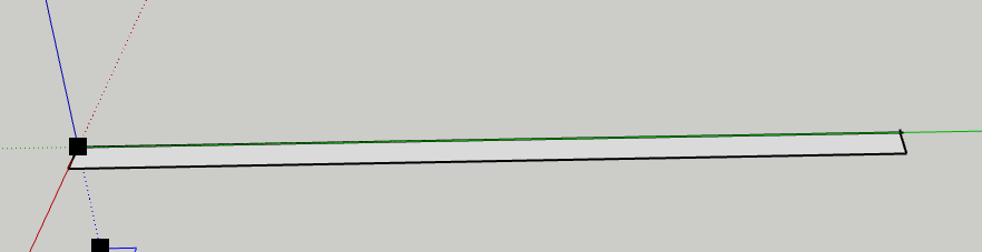

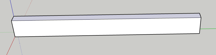

Step 1: Get a rectangle as wide as the thickness of the walls in your slicer
How do I do that in SketchUp?
First, get out this tool called “Rectangle” by searching the toolbox or typing “R” on your keyboard.
Then, make it any random length, and as wide as your walls are (as described in Part 2). After that, get the “Push/Pull” tool by searching for it in the toolbox or pressing “P”, select the rectangle you made and pull up until you feel like it’s good.

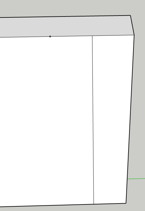

Step 2: Add a second rectangle to the first one, with the same width as the first, but shorter.
How do I do that?

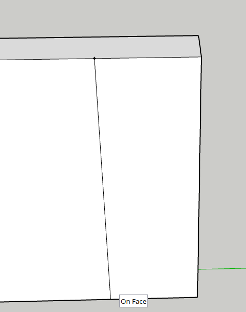

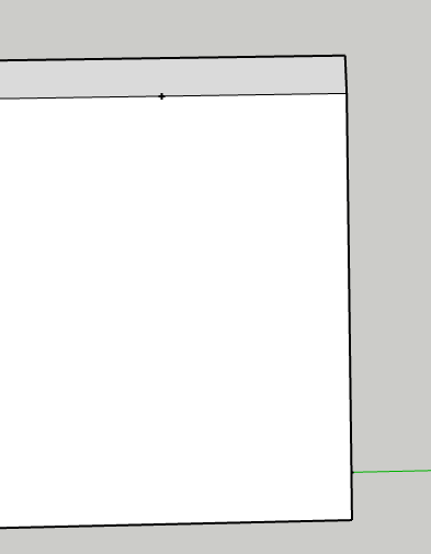

From any edge, measure the double of the wall thickness of the first rectangle with the “Tape Measure” tool allocated to the “T” key, and draw the line from the little plus that appears after you measure (MAKE SURE IT’S ON THE FACE) with the “Line” tool on the “L” key,

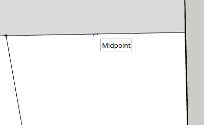

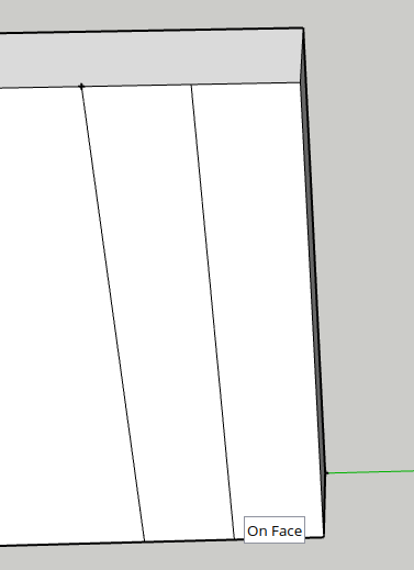

then find the midpoint between the line and the edge, and draw the second line parallel to the first line. Erase the first line with the “Eraser” tool linked to the E button. Extrude from the segment you made with the line tool

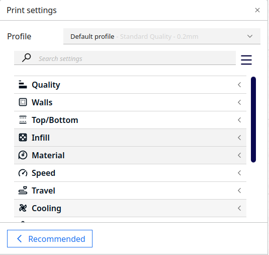

How to change the settings?

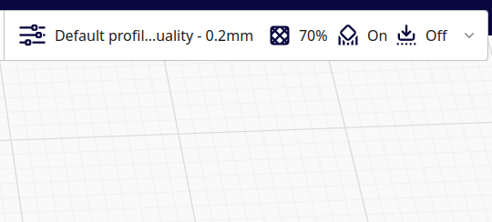

In Cura, click this:
You will see the “Recommended print settings” appear. Click “Show Custom” to find more versatile settings, and it will look like this:
Now feel free to change any settings you want.

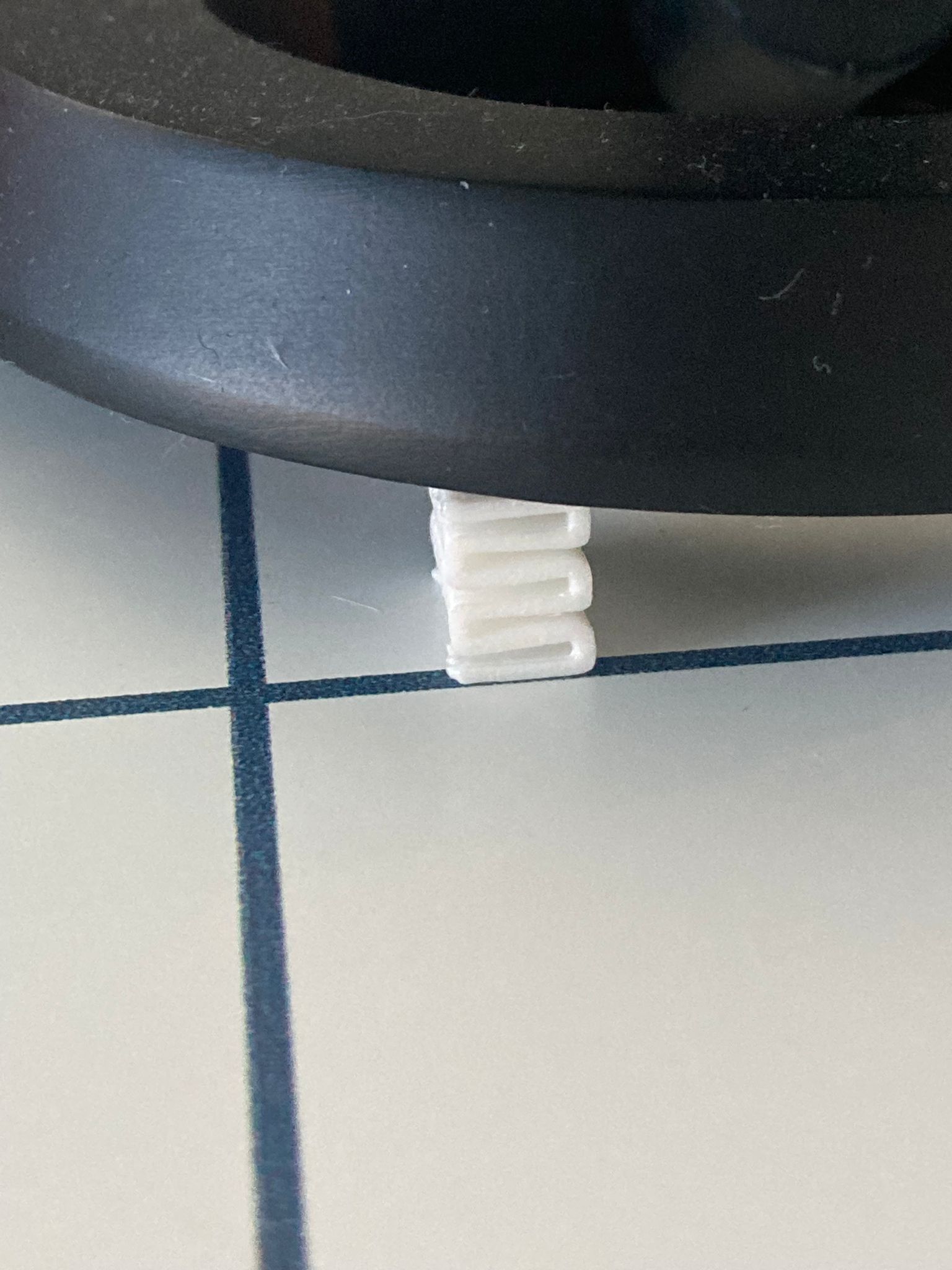

Part 5: Printing
This might be the most frustrating part about this process, which is why I have quit 3D printing several times. So make sure the settings are right!
Now, insert the removable drive into the printer, select the file and hit print. Make sure to look for any potential flaws in the first layers and check in for once in awhile- is what I would say if this was a more than 20 min print.
You can just leave it alone while printing, it took me 9 minutes to print.
