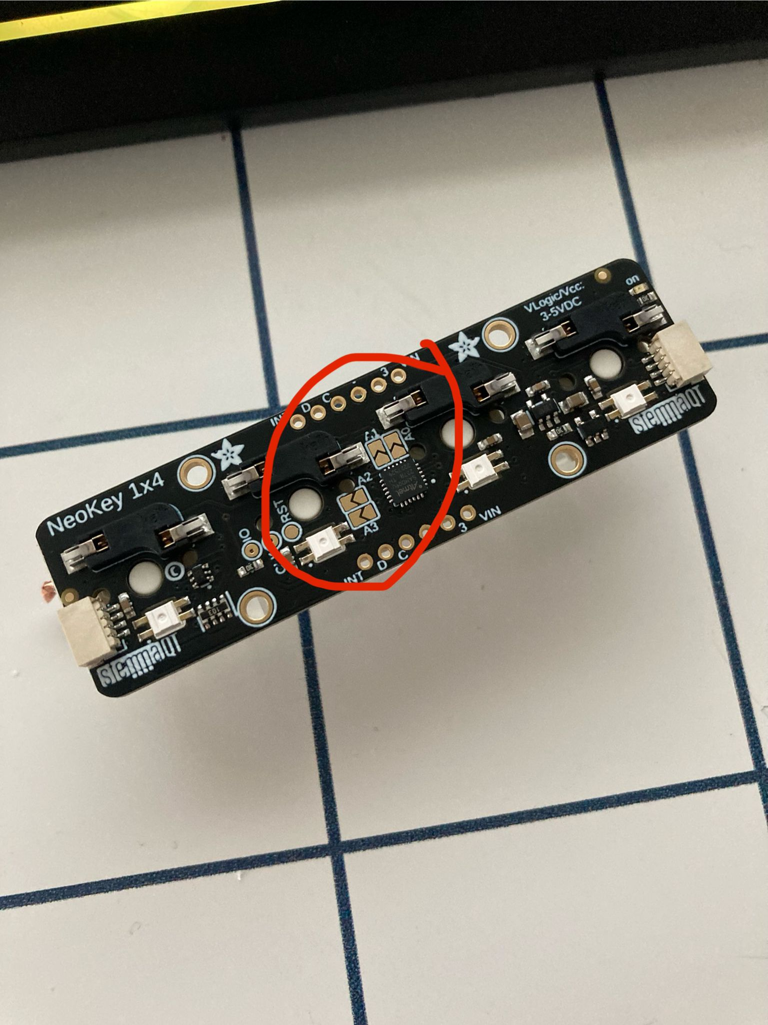

Usually, the I2C have these weird solder pads.
You might think, “what is this for?”. The answer is changing the I2C address.
This is useful when you want to use multiple I2C modules at once, but one of the modules has the same I2C address as another module you want to use.
For example, you want to use an I2C time of flight sensor, but you’re also using a screen, and both of them have the 0x3D address, and with those solder pads, you can take any one of the modules and your all-mighty soldering iron and solder it on.
The solder pads I was talking about
