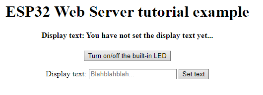

Type in the IP into your browser window. It should look like this:

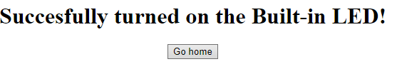

If you click on the top button, you will see this:

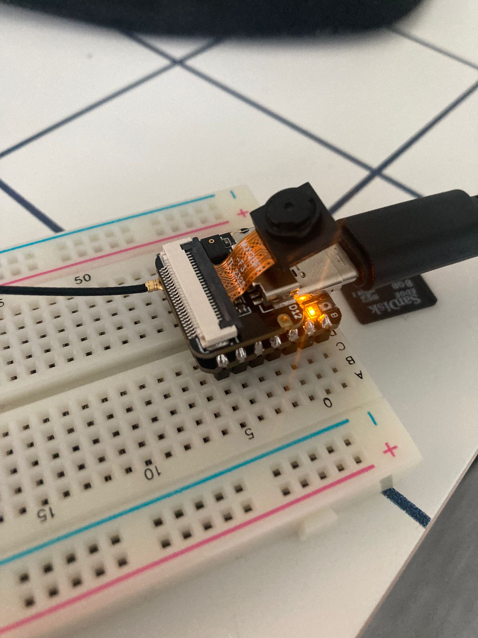

Now, look at your ESP32. It should look like this:

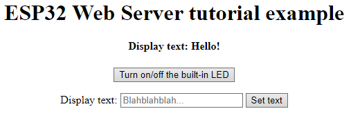

On the other hand, if you enter “Hello!” into the input field and press “Set Text” button and press “Go Home” in the next web page, you should see this:
