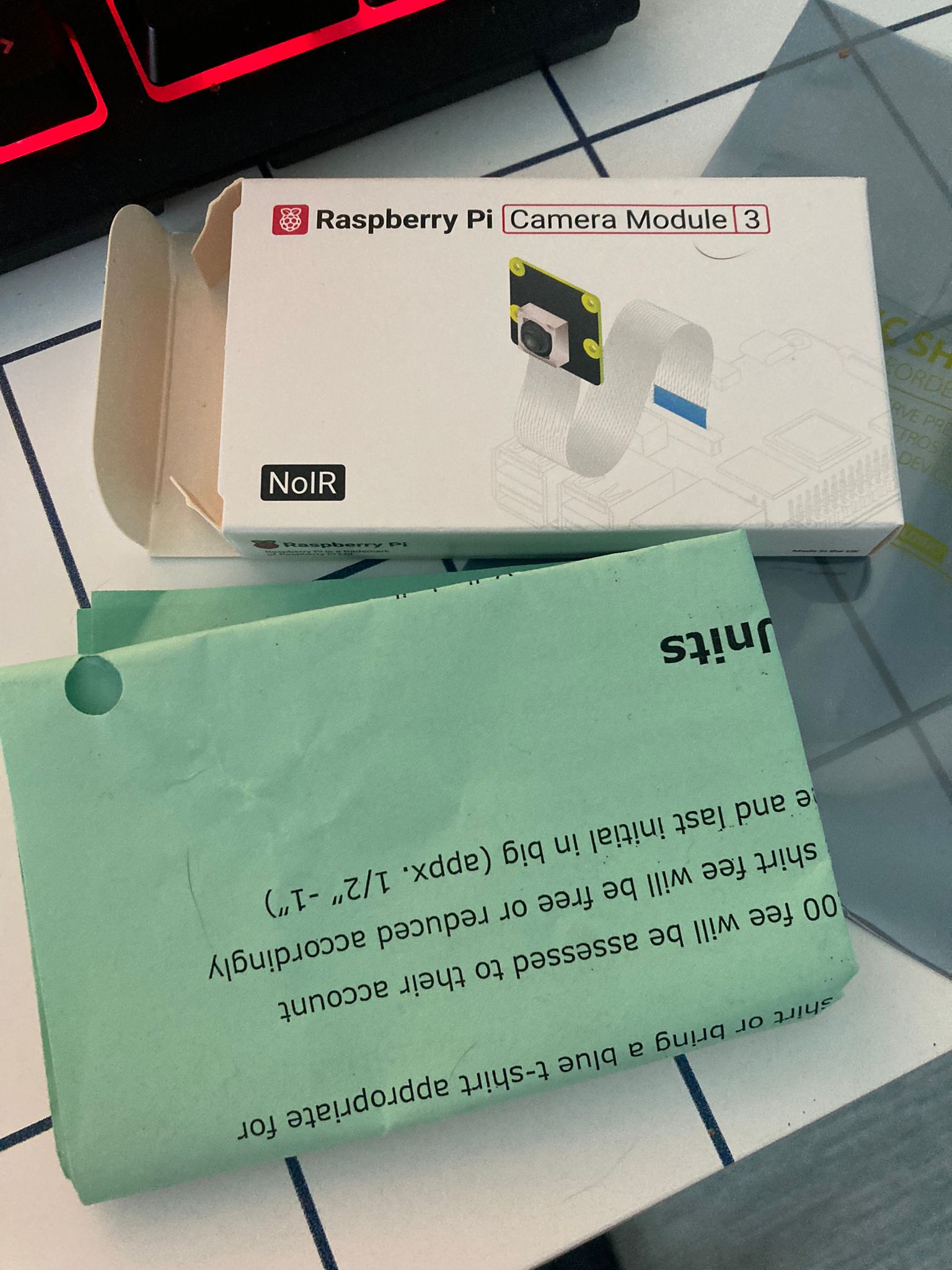

After getting the supplies, ground yourself and open the camera module box. It should include the camera, a regular cable and a piece of blue film. At first I thought that was a filter that will remove the saturation, but it made things worse on the color side.

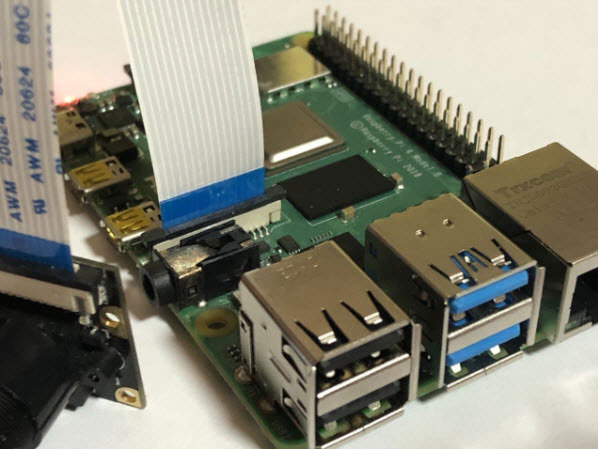

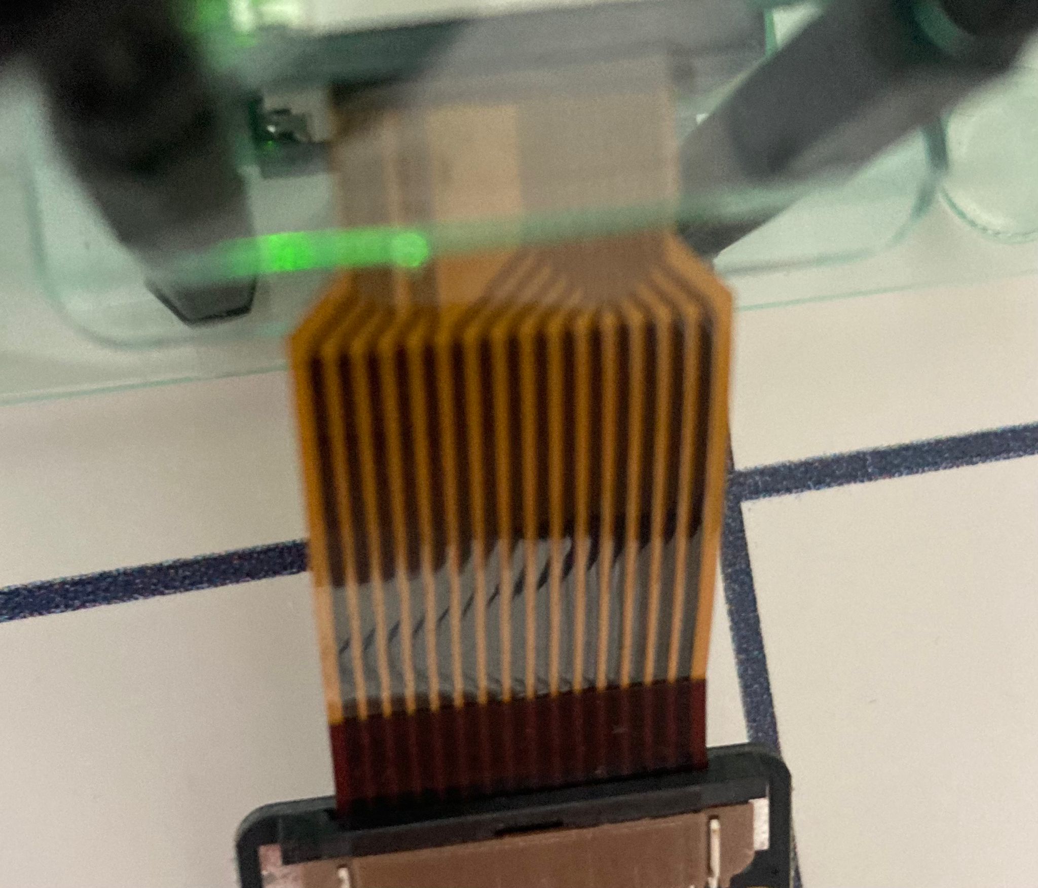

Get out your camera module, and if you’re using the Pi Zero, yoink that cable and take out the cable you bought. Both for the Pi and the camera, have the piece of film on the cable face away from the board(image 2).
If you’re on the regular Pi, then, on the most versions, film should be facing the Ethernet port(image 1). Lift up the black tab and insert in the correct orientation.
Look closely near the Pi, black film is looking upwards
